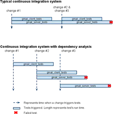

Google built a testing system that can infer which tests need to be run after a change. In their own words:
... we built a continuous integration system that uses dependency analysis to determine all the tests a change transitively affects and then runs only those tests for every change.
Inspired by that, I have created a tool for Python that also uses dependency analysis to detect which tests need to be run. The difference is that it is not tied to a CI system. It is meant to be run locally and looks for file changes since the last time the tests passed, instead of looking at commits on the version control system.
