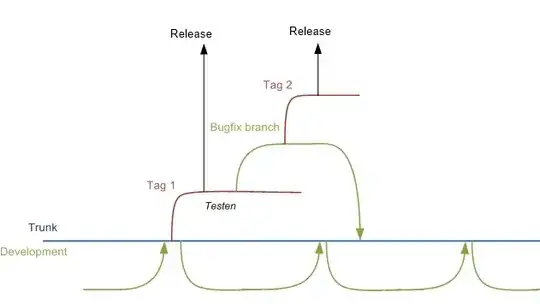

This is how we develop with Subversion:
  • There is a trunk
  • We make a new development branch
  • We develop a new feature on that branch
  • When the feature is done, it is merged in the trunk, the branch is removed and a new development branch is made from the trunk
When we want to release to production, we make a tag from the trunk. Bugfixes are made on a branch from that tag. This bugfix is then merged in the trunk.
This is why we make a new development branch after a feature is done. This way, the bugfix is included soon enough in our new code.
Below is a diagram which should clarify:
Our Subversion strategy

    I think it would be better if you had more than one branch. One for each feature. This way, if you ever do start working on a large feature that will take a bit of time, you will not hold up bug fixes and such for already released versions. – Amy Anuszewski Jul 06 '11 at 15:40
  • A branch for each feature seems to make it more complicated, while we're trying to reduce complexity. Also, if there is a bugfix (i.e. for 1.0), it can be done on a branch made from the tag. Then we can tag that branch (making a 1.1), release it, and merge the bugfix into the trunk. Development of the large feature would continue on the trunk. – Peter Jul 07 '11 at 06:57

  • I agree and OP confirmed this with: 'Sometimes, a feature is almost ready, and some developers will already start coding the next feature...' – Chris Jul 06 '11 at 16:33
  • Yes, but we never have to recompose. Features are implemented chronologically and, for example, features 1-4 all have to be in the next release (say 1.0). The only time this could be problematic is when development has started on feature 5, which is for the release after that (2.0). Then we must ensure these changes aren't taken along in the tag/release (1.0). Making a branch prior to the release could indeed fix that. – Peter Jul 07 '11 at 06:54
