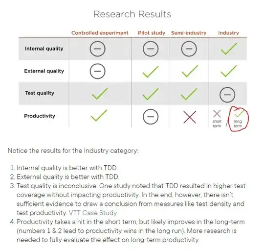

Here is a PluralSight article on evidence-base conclusions around TDD.
Some results looked at by the article are summarised below. The columns give the research source, and the rows show the outcome being measured.
  • Tick = improves the outcome
  • Circle with minus sign = 'inconclusive'
  • Cross = worsens the outcome
  • The controlled experiment shows increased productivity when using TDD
  • The pilot study is inconclusive on productivity when using TDD
  • Semi-industry research shows a reduction in productivity when using TDD
  • Industry research shows a short term reduction in productivity when using TDD, but a gain in the long term
Also see - https://theqalead.com/general/statistics-studies-benefits-test-driven-development/
