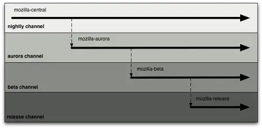

Mozilla's new release strategy is the way the repositories and code base are managed.
The major difference in the release strategy is the addition of a new channel and giving each channel a separate repository. In the past all channels were built out of the same code repository. This required a freeze anytime updates were made. With the new strategy work can continue while updates are pushed out.
The new channels are:
  • Nightly – builds created out of the mozilla-central repository every night. These are not qualified by QA
  • Aurora – builds created out of the mozilla-aurora repository, which is synced from mozilla-central every 6 weeks1. There is a small amount of QA at the start of the 6 week1 period before the updates are offered
  • Beta – builds created out of the mozilla-beta repository, qualified by QA as being of sufficient quality to release to beta users
  • Release – builds created out of the mozilla-release repository, qualified by QA as being of sufficient quality to release to hundreds of millions of people
The basic gist of the new strategy and what shortens the cycle time is the way the channels each have there own repository.
Because we are using a repo-per-channel model, mozilla-central development (and thus the updates on the Nightly channel) never have to freeze…quality convergence takes place on other repositories while Firefox development continues on mozilla-central unaffected by the release process
Chris_O
  • 258
  • I don't understand this model? Can someone please explain it? Are there different developers working on each channel? If yes, do they backwards merge their code modifications to the previous channel? If not, how can they release a stable version, while the nightly builds are always highly unstable? When a release happens, does that mean that all these channels are in sync? – siamii Aug 13 '11 at 05:23
  • found a good explanation https://docs.google.com/present/view?id=dg63dpc6_4d7vkk6ch – siamii Aug 13 '11 at 05:46
