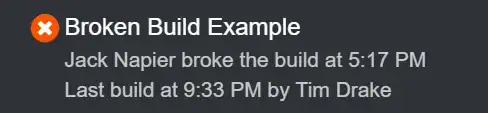

Visibility will help you out. All team members need to know that there is an active problem that they should fix. Email notifications are useful, but if a developer is busy and does not react to it immediately, he will probably forget about it and the email will end up in a huge notifications pile.
You can try using tools like Catlight or BuildNotify. They show the current status of the important builds in tray area. Every time developer looks at the clock he will see that there is a broken build that need to be fixed.
Catlight build warning status in tray
Catlight will also show who broke the build first, putting social pressure on this person, as the whole team will see it on each consecutive build failure.
