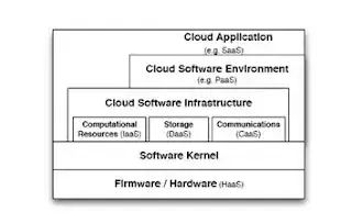

This answer is from an article that I read "Toward a Unified Ontology of Cloud Computing"
  1. As Google App Engine gives you a platform for better utilization of Google's resources, it can be considered PaaS. A good key for me is "Is this environment giving me some kind of API for better integration with a system? Then it's PaaS."
  2. I read more than one definition about this, but nowadays what sounds better to me, and what the article writer says, is that HaaS, like CaaS (communication as a service) is a subset of IaaS: they create the infrastructure needed to perform IaaS, but it can't be considered essentially service like IaaS.
Here is a figure that describes what I'm saying:
cloud layers

Not sure about 1.
As for 2:
It is, ideologically, a subset. That is to say that in an IaaS I don't think it's necessary that the infrastructure elements treat the hardware as a service per se - it could be a proprietary OS/etc. dedicated for proprietary hardware.
The differentiator is that the OS could belong in an IaaS but not in an HaaS.
