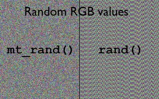

To visually illustrate how non-random the rand()function is, here is an image where all pixels are made of "random" red, green and blue values:
Random RGB values
There normally shouldn't be any pattern in the images.
I've tried calling srand() with different values, it doesn't change how predictable this function is.
Note that both aren't cryptographically secure and produce predictable results.
