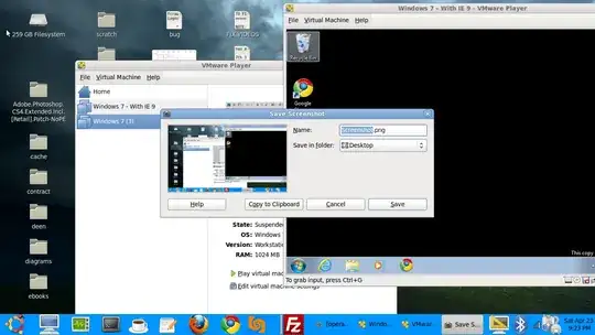

I have been using Ubuntu for web development. At times there are cases when I need to check for cross browser compatibility. Yes Ubuntu has very nice support for vmware and works just absolutely fine with no hiccups. I have a couple of instances of windows 7 virtual machines with different apps installed e.g. Ie8, ie9 etc. They start-up pretty fast also.
Apart from that development on Ubuntu is amazing. No annoying pop-ups messages, no notifications, alerts, viruses, malware etc. You can absolutely concentrate on your work. Ubuntu is pretty fast to startup and shut down too.
Working on the apple, I could never get used to the separation of the menu bar and application window. Never comfortable when multiple windows are open.
Screenshot: Ubuntu
