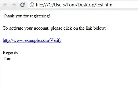

It will render as follows:
But the HTML in the email is as follows:

    I think it's generally a bad idea to assume users will do the most intuitive thing. (Which is, in this case, clicking the link outside the `h`.) – Maxpm Apr 21 '11 at 16:48
  • @Max, every CAPTCHA will have limitations, the question is though I suppose, will more users fail the clicking the h link, or will more fail/be put off by a traditional CAPTCHA? Also the H link being clicked can simply mark the account as suspect, and limit their abilities until they have been manually verified. – Tom Apr 21 '11 at 16:50
