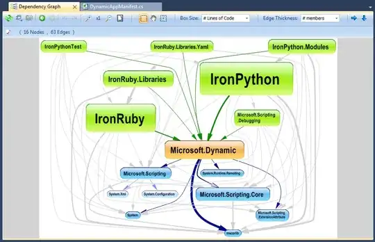

One important thing to do is to use tooling to generate dependency graphs to top-down explore code architecture. First visualize graph between .NET assemblies or jars, this will give you an idea on how features and layers are organized, then dig into namespaces dependencies (inside one or a few relatives .NET assemblies or jars) to have a finer grained idea of code structure and finally you can look at classes dependencies to understand how a set of classes collaborates to implement a feature. There are several tools to generate dependency graph, like NDepend for .NET for example, that generated the graph below.
    There are countless of tools that can create readable dependency graphs with some sort of hierarchy, but this doesn't seem like one of them. I also work with electronic design, and for that there's a rule of thumb (literally): if I have to follow a line your schematic with my finger at any point, it is a bad schematic. –  Jun 28 '11 at 11:10
I once had a pretty fantastic software engineer tell me that the most expensive form of code analysis and maintenance was to walk through the code, line by line; of course, we're programmers, and that pretty much comes with the job. The happy medium, I think, is to (in this order): 1. Get a notebook to create notes for how you understand the code to work, and add to it as time goes on 2. Refer to documentation about the code 3. Talk to authors or others who have supported the code base. Ask them for a "brain dump" 4. If you're to the point where you understand some of the detail-level class relationships, do some step-through debugging of the code to do some synthesis between how you thought the code works and how the code actually works.
