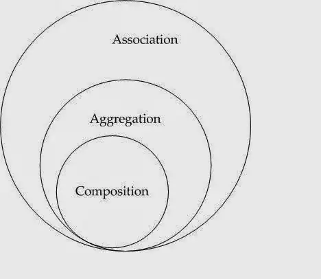

  • Composition is an Association
  • Aggregation is an Association
  • Composition is a strong Association (If the life of contained object totally depends on the container object, it is called strong association)
  • Aggregation is a weak Association (If the life of contained object doesn't depends on the container object, it is called weak association)

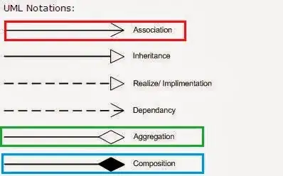

Composition(mixture) is a way to combine simple objects or data types into more complex ones. Compositions are a critical building block of many basic data structures
Aggregation(collection) differs from ordinary composition in that it does not imply ownership. In composition, when the owning object is destroyed, so are the contained objects. In aggregation, this is not necessarily true
║           ║       Aggregation       ║      Composition      ║
║ Life time ║ Have their own lifetime ║ Owner's life time     ║
║ Relation  ║ Has                     ║ part-of               ║
║ Example   ║ Car has driver          ║ Engine is part of Car ║
Both denotes relationship between object and only differ in their strength. enter image description here
UML notations for different kind of dependency between two classes enter image description here
Composition : Since Engine is part-of Car, relationship between them is Composition. Here is how they are implemented between Java classes.
