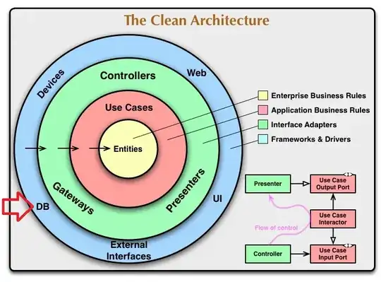

  • See [this diagram](https://blog.cleancoder.com/uncle-bob/images/2012-08-13-the-clean-architecture/CleanArchitecture.jpg). If you want something to be accessible from any ring, you have to put it in the center circle. The inner rings can't access anything in the outer rings (the Dependency Principle), so putting it anywhere else will exclude it from some your features. – Robert Harvey Apr 19 '23 at 11:35
  • Why DB is then put on the outer circle when it should be accessible from the entities? – Jim Panse Apr 19 '23 at 11:38
  • That's a good question. I never much understood a lot of Uncle Bob's teachings. But the principles are clear: if you want it to be accessible from anywhere, it has to go into the center circle. – Robert Harvey Apr 19 '23 at 11:38

enter image description here github.com - esakik
Can you look at that and tell me if Data Access is a long lived object that was built in main() (Who needs singletons?) or something that the Use Case Interactor had built just now? Nothing in these diagrams answers that question. So you're free to do it either way and can still claim you're following Clean Architecture.
Why DB is then put on the outer circle when it should be accessible from the entities? Jim Panse
The DB is accessible from the entities. Remember, this is a dependency diagram.= Not a data flow diagram.== Those black arrows going into the circles don't mean this is a roach motel that traps you inside.
Uncle Bob tried to make that clear with the little "Flow of control" diagram in the lower right corner. Notice Presenters dependency arrow points to Use Case Output Port but the Flow of control goes exactly the other way. That's what they call dependency inversion.== Because of that, control can dive into a lower layer and come back out. All without using return!

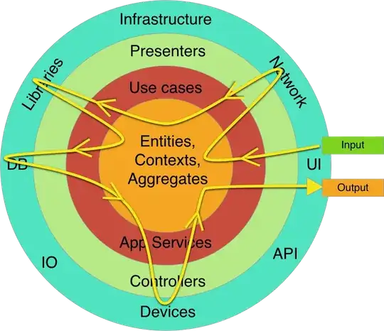

And if you can do that, you can do this:
enter image description here crosp.net

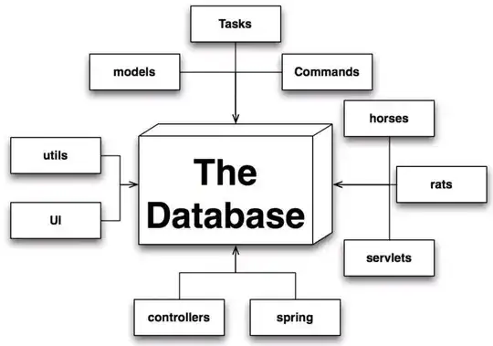

So don't feel like you have to do this:
enter image description here slideshare.net
