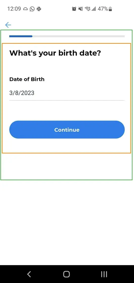

Here's the date of birth page that better describes it:
  • The green bounding box represents the "Layout" on 1. and the "Master Layout" on 2.
  • The orange bounding box is the content that changes across each wizard step.
Note that both approaches render the same UI.
