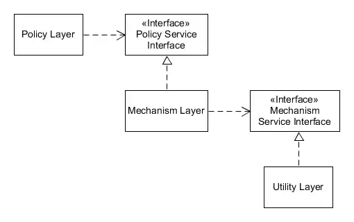

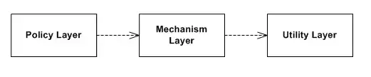

The prohibition is against directly depending on a concrete type not against injecting one. It's mentioned in the Dependency Inversion Principle.
It says rather than doing this:
You should do this:
You can do that while injecting Mechanism into Policy just fine. The point is, statically, Policy should have no idea what is going to be injected. All it knows is that it'll be some Mechanism like thingy. Knowing that tells Policy how to talk to it. But that doesn't tell Policy what the Mechanism will do about what it is told because Policy doesn't, statically, know which Mechanism this even is. That hides the implementation details.
All of that is defeated if Policy constructs Mechanism itself and so knows exactly which Mechanism it's depending on. That would be "directly depending".
Something else constructing Mechanism and injecting it into Policy is fine so long as Policy knows no more about it than what the interface tells it.
This may sound like you need the keyword interface but really you just need some kind of abstraction. Which is nice because some languages don't even have that keyword.
