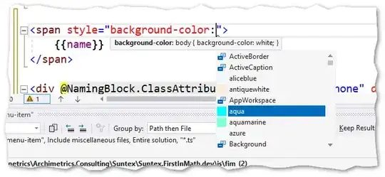

If you were writing this HTML in a *.html file, you might have something like
<span>
    {{name}}
</span>
and you'd have great Intellisense and editor experience for the span, like if you wanted to add a style attribute:
The editor would also catch malformed tags, unclosed tags, tags that can't be nested as written, and lots of issues of that kind.
