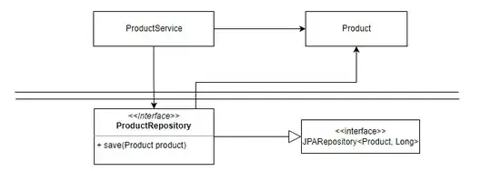

According to Should I use a layer between service and repository for a clean architecture - Spring the Peristance layer is deprecated because the Repository is already an abstraction.
UML solution of the previous questionenter image description here
Product and ProductEntityJPA

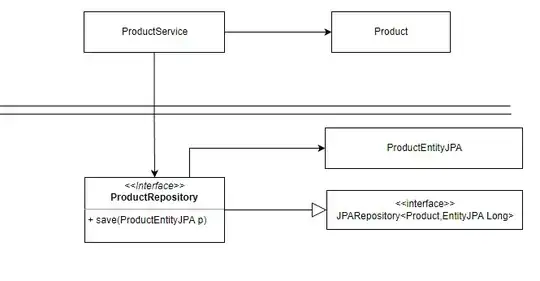

But, in reality we have to use two entity :
  • One for the domain entity Product
  • One for the database entity ProductEntityJPA
The following UMl diagram represent the new solution. Please take note that the method save take now an ProductEntityJPA
How ProductService use ProductRepository ?
public ProductService {
    private ProductRepository productRepository;
    void registerNewProduct(Product product) {
        productRepository.save( /* give a ProductEntityJPA */);
The ProductService class is aware of the JPA framework. We have therefore broken the rules that the Service layer is independent of any framework.
How to avoid dependencies between ProductService and ProductEntityJPA ?

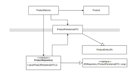

Create a DTO
Inheritance
The ProductPersistanceDTO has to extend ProductEntityJPA because the method save in JPARepository is
public <S extends T> S save(S entity)
Solve the problem ?
So have you solve the problem, because by inheritance ProductService can access to the ProductEntityJPA ?

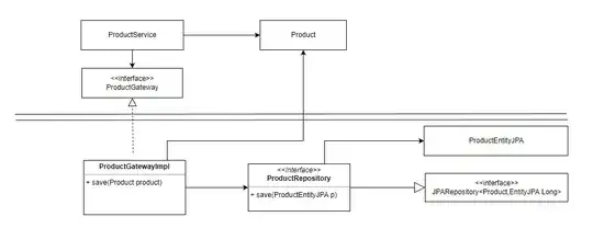

Create a new layer (Adapter pattern)
Come back to a solution with the persistance layer where the ProductGatewayImpl is an adapter
public ProductGatewayImpl {
    void save(Product product) {
        productRepository.save(  transform(product) );
    private ProductEntityJPA transform(Product product) {
        /* transform */
        return productEntityJPA;
What do you think
  • Do you think that the Persistance layer is useless (url link) ?
  • Do you think that the DTO is an solution (be aware of the inheritance) ?
  • Do you think that the Peristance layer (gateway) is an solution ?

  • Hi Adri! Welcome to SE. I'm afraid to say that I have voted to close the question. I have found several reasons to do so. 1st it's not a question, it's an answer to the linked question. 2nd, the "answer" you give (gateway) is basically what OP's ask if it's necessary. As usual, the answer is "depends". However, in my experience working with Spring, it's not 99% of the time. Even my answer (decoupling from Spring) is counterproductive, but I had to illustrate how to decouple "core" from "framework". 3rd, Questions like _"what do you think"_ only leads to debate and opinionated answers. – Laiv Nov 24 '22 at 10:34
  • Thank you for your answer and I understand your arguments. I will do that – Adri Nov 24 '22 at 14:26
