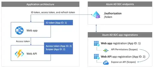

[ client app ] -- authenticate & get access token for api --> [ Azure AD B2C ] OK
[ client app ] -- send access token to backend api (resource server) --> [ flask api ] OK

Please read for context:
I am new to authenticating webapps with Azure AD B2C. I have previously used flask-jwt-extended library to authorize and authenticate my Flask web apis where the user database was on my own server (I believe this is called 'implicit flow').
The whole 'modern' identity ecosystem is quite overwhelming and the documentation from Microsoft on using their solutions is very demanding. I have gone through most of their articles and tutorials thoroughly but some things seem still unclear.
My client app (Vue.js SPA application) fetches an access token from Azure and then sends it in the header of a HTTP request to my flask API (=resource server). There I need to validate if the token is valid and unmodified. Then I need to check if the scopes of the access token authorize calling a specific endpoint / resource. Below is the architecture.
