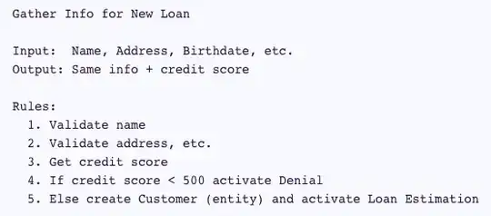

Analysis of example at figure 20.2 (Chapter 20, Use cases)
So, the "A use case is an object". It's hard to implement above use case with one function - it will be the class with one public and multiple private methods.
For this example, there is no need to extend LoanUseCase from Loan. The code draft will be like:

class LoanUseCase {
  public static issueLoanOfPrimaryCourseIfPossible(customerRawData: CustomerRawData): Loan | null {
    if (!LoanUseCase.isCustomerDataValid(customerRawData)) {
      return null;
    if (!LoanUseCase.isCreditScoreEnough(customerRawData)) {
      return null;
    // create new customer and save him to data store
    return new Loan({
      period__months: 12,
      principle: Loan.Principles.standard,
      rate__percentage: 15
  private static isCustomerDataValid(customerRawData: CustomerRawData): boolean {
    // validate name ...
    // validate address, birthdate, etc.
    return true;
  private static isCreditScoreEnough(customerRawData: CustomerRawData): boolean {
    return true;
