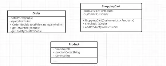

The UML is listed below. There are different products with different preferential strategies. After adding these products into the shopping cart, the caller needs to call the checkout() method to calculate the totalPrice and loyaltyPoints according to its specific preferential strategy. But when a new product comes with a new preferential strategy, I need to add another else if. This currently breaks the open-closed principle.

    The knowledge which product type corresponds to which discount policy should not be coded into the checkout routine. You should represent this either in the product class (a product understands its own discount properties) or in a separate discount managing module (which understands both product and discount types). – Kilian Foth Sep 12 '22 at 08:05
  • I took the freedom to improve the wording of this question. Please double check if I got your intentions right. – Doc Brown Sep 12 '22 at 08:10
    In most reasonable real-world systems, I would expect the business people to be able to change the discount strategy, the loyalty points strategy, and the list of available products with their product codes, without asking a programmer for each new product. That, however, would require a more general approach. So **please clarify**: what is the expectation of the business here in your case? Or is this just a learning example for you? – Doc Brown Sep 12 '22 at 08:21
  • There is no specific expectation.I just think this implemention is bad.So I just wanna some advice.I have an idea :Mybe I can make the Product as an interface and let the product with different preferential strategies to implement the interface. Am I righ?.Do you have other advice? – Abner Sep 12 '22 at 09:00
  • @Abner: I think you did not get my point, because what to do depends a lot on the specific context of your case, which you did not tell us. But maybe my answer can clarify things. – Doc Brown Sep 12 '22 at 09:05
    @Abner we (almost everyone here) wonder if the refactoring is only limited to `ShoppingCart` (something I deem insufficient) or can be extended to `Product`. – Laiv Sep 12 '22 at 13:36
  • Your if-branches are almost exactly the same; start by DRYing up your code. You'll get a parameterized method and no if-statements. Turn that method into an object (`DiscountStrategy` or something), and make the parameters into fields. Now, either associate different instances with each product (`product.getDiscountStrategy()`), or maybe create a factory (simple static function) that takes a product, reads the product code and returns a discount strategy on the fly (inject the factory into `ShoppingCart` class). I know this is rather condensed, but, create a git branch and do an experiment – Filip Milovanović Sep 12 '22 at 18:50
  • @Abner have a look at the visitor and strategy patterns. These will help you decouple the various preferential strategies from the products. All of this is simpler and more flexible when the preferential strategies are first class citizens in your object model and the products are "ignorant" of them. – Jason Weber Sep 13 '22 at 03:30
  • @Laiv no limited – Abner Sep 13 '22 at 11:43
  • I tried to write an answer and then I realised that I would be just writing one (of many possible) pseudo-solution with very little value for the community. I also realised that, unless I can make the relationships Product - Discount and Product - Loyalty plan dynamic, I would be just moving those IF from one side to another. In the end, I remembered a word @candied_organge uses a lot in these cases and worked for me many times. _Procastionation_. Just don't resolve the discount and the loyalty earned too soon in ShoppingCart. Abstract it and solve the concrete details later. – Laiv Sep 15 '22 at 12:35
    @Laiv: moving those "if"s from one side to another can be meaningless or meaningful, depending on what those "sides" are and if there are different organizational units responsible for the "one side" or "the other". That is the whole point of my answer. Unfortunately, the OP did not give us any clue so far what the organizational units are in their case, and against whose "changes" the code should be closed, and for whose extensions it should be opened. Because of the missing response, I suspect they are just trying to treat the OCP as some braindead "best practice" without really knowing why. – Doc Brown Sep 15 '22 at 18:35
The OCP is about allowing "team 1" to provide a black-box framework containing classes like Product, Order, and ShoppingCart, and "team 2" to change the list of products and the discount strategy without asking team 1 for a change in their code.
There are usually three major situations to consider:
  1. "Team 2" is a second development team. "Team 1" has to provide "injection points" for team 2 where they can provide new discount strategies along with new products.
  2. "Team 2" are the business people. They don't want to ask the programmers, but simply add new products and discount calculation rules at run time through some nice GUI or configuration files.
  3. Team 1 and 2 are identical (there is no "team 2"). So whenever the business people add a new product or product code which does not fit to the current discount logic, they ask the devs of team 1 to implement this, for each and every minor change.
For case 1, there are several options. The goal is to allow team 2 to provide new discount rules without changing the original ShoppingCart or Product code. Team 1 may provide an abstract interface PriceCalculator, let the the checkout method take an object of that type and let team 2 pass a concrete PriceCalculator object as a parameter. Team 1 may let team 2 add new product codes into some list or database table. Alternatively, one could also decide to let team 2 provide a list of DiscountStrategy objects as a parameter to checkout. Each of those DiscountStrategy objects could have a method Discount calcDiscount(Product), which returns null in case the strategy does not apply, or a discount object (with the discount and loyalty points) in case it applies. Then, the checkout method can simply iterate over the DiscountStrategy objects and stop when the first call to calcDiscount(Product) returns something different from null.
For case 2, one needs to parametrize all kinds of discount calculation rules, store that parameters in some database or file and and implement a generic PriceCalculator module which can evaluate that parameters (along with some UI for the business people to change them). In your contrived example, this looks pretty simple: introduce a parameter object with three attributes ProductCodePattern, DiscountFactor and LoyaltyPointsFactor. However, reality, discount strategies will often be more complex, requiring different formulas for different product codes.
In case there is more flexibility required, the PriceCalculator could be some small "DSL" (domain specific language)" interpreter, and the business people specify their discount rules using that DSL.
For case 3, applying the OCP is probably overdesign and not necessary. Nethertheless it may be a good idea to extract the price and discount calculation from the shopping card into some PriceCalculator class, for increased testability. Since the discount calculation depends mainly on the product, it probably fits better into the Product class itself. But beware, inheriting from the Product class and providing a different discount calculation rule for each subclass is most probably the wrong approach here.
So in short, for applying the OCP most sensibly, one needs to know the organizational context. The OCP is not an end in itself, you need to know which parts of your code should be open for changes to whom, and which should be closed to whom, and for what purpose.
