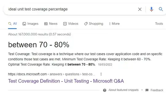

Google tells me that the ideal unit test coverage is 70 - 80% screenshot of Google search result
(although Google's source for that doesn't look especially credible). This old post suggests that in fact it depends on what gives you confidence to release. Which is right?

  • @Tyberius, thanks - I have clarified the reference – OutstandingBill Sep 07 '22 at 22:16
    @OutstandingBill Google searches are not stable over time, location and user. When I click your link, Google actually gives me "95% or higher" as the answer... Might be better to just link to your source directly rather than a Google search that will show very different results to different people. – Marc Sep 08 '22 at 15:32

Coverage is not an end. It's not even a mean to an end. It's just an "objective" metric interpreted "subjectively".
That said, it should not be used as an argument to don't do tests! Ever! You can propose doing fewer tests when you can prove that those few are enough to provide the so-called confidence. It's then when you can back, with results, a different % or do fewer tests.
1: Whether that 80% is generated by good tests or not is a different subject.
