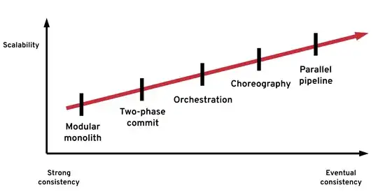

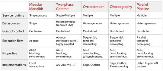

There are even some ideas of using Event Sourcing and Event Store itself as a message broker... This solution and others are described in this red hat article.
