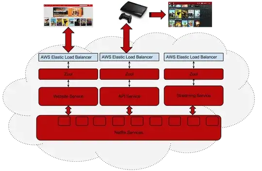

That being said, Netflix internally runs an instance of Zuul for each service. See their architecture:
Netflix webservice architecture diagram
Source: How We Use Zuul At Netflix
This still maintains much of the benefits of an API gateway, however it has one obvious problem—it passes the problem of service discovery on to the service consumers (other services and/or clients):
In the case of a single API gateway, the gateway is reachable at a well-known IP address or DNS name, and all service discovery can occur within it. This means that code calling some service will only need the name of that service and the well-known address of the single gateway.
However, with one gateway per service, code calling some service will need to know the address of that service's API gateway. This would require an external service discovery system, perhaps something like Netflix's Eureka.
