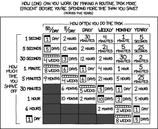

Lets take this XKCD literally:
Is it worth the time?
You wrote it took you 30 minutes to automate a task which manually takes 30 seconds. Now lets make the conservative assumption that you will run your automated test suite (which includes the test) at least once a day - then you find the break-even point for a five-years return-of-investment at 2 hours of development time. According to this simple model, it seems to be clearly worth it, at least when you expect a life-time of your program of five years or more.
Of course, in reality, things are not that simple. The tests themselves are code which requires maintenance and debugging. Specificially for user interface examples like the ones mentioned in the question such tests can become sometimes brittle and require extra effort whenever one wants to change the slightest things afterwards.
Hence, this is usually a trade-off, and there is no easy answer to this. The "correct" answer will depend on a hell lot of factors like the whole project situation, the quality expectations of your audiences, your own expertise, the expected stability of requirements, the expected life time of the program and more.
