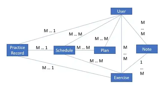

Here is a diagram showing the objects and how they relate to each other (ignore the other objects, I included them to give more context): model diagram

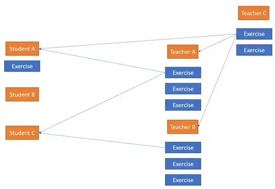

This is an example of a possible scenario with different students and teachers: enter image description here

You have to distinguish between
  • the owner of an exercise, and
  • it's visibility (or accessibility) to other users
The first relationship is a 1:M relationship, hence your exercise will still need a user id (call it something like OwnerID), even when the second one is implemented as an M:N relationship.
Currently, you are trying to use a general term "membership" to mix up both, and that's why things become messy.
Doc Brown
  • 199,015
  • 367
  • 565
  • That makes sense. The way I implemented this at the moment is to replace the ```Guid UserId``` with ```IEnumerable AssignedUsers```, which works fine in terms of sharing objects between users, but leaves me with the question of 'who can edit/delete an exercise?', which would be very easy to answer if I had an owner for the object. On the other hand, it wouldn't help with allowing a user other than the owner to edit – Kappacake Apr 05 '22 at 11:14
  • @demonicdaron: specific user rights (for example, the permission to edit even if a user is not the owner) can be stored in the junction table which implements the visibility (or accessibility) relationship. – Doc Brown Apr 05 '22 at 11:49
  • Right, I see. What is the point of the 'ownerId' at this point? At the moment, I removed the need for a junction table based on the fact that I only need to access the userIds from the object and not viceversa – Kappacake Apr 05 '22 at 13:05
    @demonicdaron: well, it expresses ownership, which means, when the owner of an exercise gets deleted, their exercises get deleted as well. Or, the owner may be the only one who has permissions to change the accessibility for other users. But if you don't need that concept, because exercises don't belong to anyone special and can exist without any owner (which is quite contrary to the wording in your question), then you can probably omit the OwnerID. – Doc Brown Apr 05 '22 at 13:16
