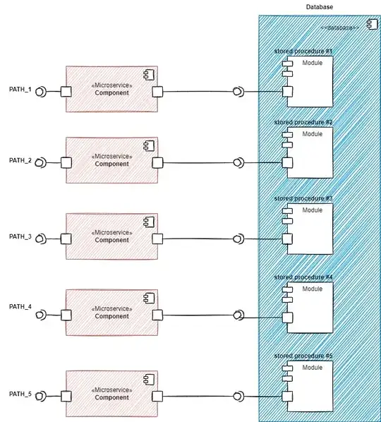

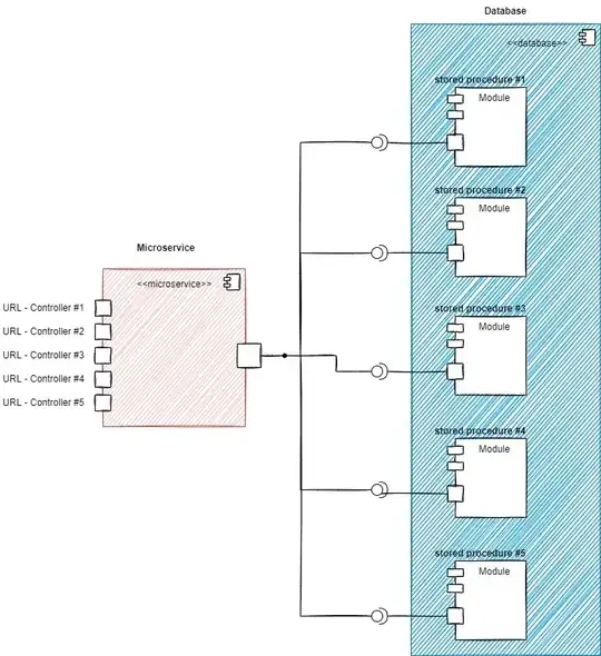

I have to build a micro service for my company, the backend is an Oracle database, but the micro service must consume five (5) stored procedures that already exist in the database (as shown in the screenshot). The database architecture can't change.
My question is: must I build only one (1) micro service that consumes these five(5) stored procedures?
Single microservice accessing multiple stored procedures
Or must I build five (5) micro services that consume each one of these stored procedures?
Multiple microservices each accessing a single stored procedure
I'm very confused about making that decision, because in most architecture notes about micro services, one micro service should exist only for one database but this way it wouldn't be a decoupled solution. But the other hand, if I build five micro services, each one using a stored procedure, it would be five services that share the same database or repository of data.

    What is the role of your service? Does it do some processing on the data from the database? I mean, the first question I have seeing the second picture is "why have a service and not query the database directly"? Perhaps with some library helper for interfacing. OTOH, if you need to have any sort of processing involving data from multiple stored procedures, the second picture is out of the window immediately, because it simply doesn't work. – Frax Feb 08 '22 at 17:07

    Beware that multiple micro services using the same database is just another form of a distributed monolith. Also, "micro" doesn't necessarily mean itty-bitty, eency-weancy. Micro services can still be bigger as long as they are independently deployable and scalable. You will see those terms repeated in answers and comments. A micro service must be **independently deployable and scalable**. That alone can help lead your decision. – Greg Burghardt Feb 09 '22 at 03:48
  • `FWIW, both approaches are more an "API" and less a "microservice"` So call it an "API Gateway", and then it becomes clear that having all the endpoints in the same service is fine, as it's really just a protocol adapter. – David Browne - Microsoft Feb 09 '22 at 14:19

With your constraint of a fixed database architecture, I would design a single service for that and, independently of whether that service meets all the checkboxes for a micro-service, call it a micro-service (for political reasons).
In short, create the best design given the technical constraints and then slap on the buzz-word labels that people want to see.

Giving a benefit of doubt and assuming this is just first step moving towards decoupled service architecture at your company.
You can think of a 1 stored procedure as one logical unit of work needed to be completed. May be the current procs are very complicated and they are doing lots of cross db queries, linked server calls and all possible workflow that does not fit in the expected end goal. in that case someone has to work lot more on data refactoring.
Or may the procs are simple enough that with little modifications they can be lift and shift to their own db along with underlaying data they need. Whatever the case with procs I am guessing someone is thinking about it doing later or at least it's part of the bigger plan.
So I would lean towards one service for one proc so that later when you guys refactor db components it will more or less align with end to end (application+db) independent deployable service architecture.
That is just MPO based on limited information we have here.
