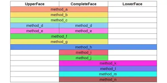

Let's take a look at the table below. Again, for the sake of simplicity, I am using generic names for the methods.
Both the CompleteFace and UpperFace objects have method_a and both objects implement method_a in the same way. Maybe method_a could represent the eye width. The same logic applies to method_b and method_c. The LowerFace object does not have these methods.
Similarly, both CompleteFace and UpperFace have method_d that represents the same geometrical quantity, however the two objects implement this method using a different algorithm.
method_h is common to all of the three objects and the method is implemented in same way. For instance, this method allows to compute the area of the mesh by summing the area of the triangles composing the meshes.
method_i and method_j are methods implemented only for the CompleteFace object.
The remaining methods (method_k, method_l, etc.) are implemented in the same way by the CompleteFace and LowerFace objects but are not implemented for the UpperFace object.

Perhaps, multiple inheritance could be used. We create the UpperFace class and the LowerFace class. Then, we create the CompleteFace class which inherits both the UpperFace and LowerFace classes. So, the CompleteFace class inherits method_a, method_b and method_c and there is no need to modify/override them. While method_d needs to be overridden. Finally, method_i and method_j are added. This seems to be a good solution, however multiple inheritance is usually considered a dangerous tool, because of problems like the diamond problem.
Is multiple inheritance the right choice for this problem or should be avoided in favor of other solutions based, for instance, on composition?

I would heavily recommend against using inheritance, this will sooner or later bring you into such kind of trouble mentioned by gnat in his comment. Instead, the very first thing I would recommend here is to design all the methods in a way they make sense for all types of faces.
This may result in certain methods simply returning zero (for example, the eye width for a face with no eyes could simply be zero). If zero isn't a good fit, use NaN, or return an error value, or throw an exception, whatever fits best.
When you are implementing these methods (and give them better names, not just method_a, method_b, ...), you may find out some of them are operating just on certain subdata, for which it may make sense to introduce certain classes on their own. For the sake of this example, lets assume own classes for Mouth, Eye or Nose to be such candidates. Or maybe it is better to have a class FacePart, or maybe that could be a base class for the former: I don't know what fits best for your case, but you get the idea. Now composition comes in: the Face object will contain certain FaceParts and delegate parts of the calculation to those.
How to design these ideas exactly is nothing I would decide up-front here. Better start implementing the methods and refactor whenever you find commonalities or occasions to extract the code into smaller units.

Multiple inheritance is a dangerous tool, like a chainsaw is a dangerous tool. When you know what you are doing, you can safely use it.
Your example of calculating metrics from scan of potentially damaged sculptures seems to be tailored to suggest multiple inheritance might be a solution. On the other hand, it does not account for the possibility that a left or right half of a face might be missing. Or just the nose or a single eye only.
For calculating geometric properties from potentially damaged sculptures, I would use just a single class and document for each method that it can also return or signal "cannot compute this property from the input data". No inheritance needed on the interface class(es).

  • Thanks for your answer! You are right about the possibility of having also the left/right half of the faces, so I have edited my question. I understand your solution, especially for methods like `method_i` and `method_j`. However, what about methods like `method_d`? Would you simply use an `if...else` statement? – blunova Dec 26 '21 at 21:14
    The issue here is that these are not different types of faces, but different attributes of the same face that might or might not exist in a large number of possible combinations. By using multiple inheritance, you limit it to only one attribute, or you end up writing a class for each possible combination, which can explode quickly. – user10489 Dec 27 '21 at 05:40
    @blunova, For `method_d`, I would first try the calculation for a full face and if that fails, try again for an upper face. – Bart van Ingen Schenau Dec 27 '21 at 07:59
