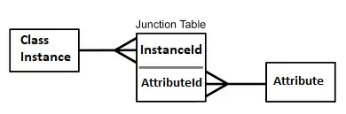

If the attribute is volatile and not always needed, look at how databases do this..
In databases, you implement occasional, loose relations between data by using junction table records, connecting records from one table with other records in another table.
In this case, you'd have a ClassInstances table with an index named ClassInstanceId, and you'll have a table Attributes with an AttributeId. You introduce new table named InstanceAttribute only containing the indexes you want to connect..
Advantages of this approach, also when it is used in memory: (1) you don't have to change your Class declaration to add Attributes.. (2) you can have an arbitrary number of attributes per instance and (3) you could store attribute sets only once, share them.

    But writing the code isn't the same as a database schema, right? There is no straightforward way to implement something like a temporary junction table to an OOP model. The closest equivalent would be to use a dictionary that maps the ID (memory location) of objects to the additional data. So instead of `self.depth` one might access `depths[id(self)]`. I don't think that's a good design though. – amon Dec 04 '21 at 21:36
  • In memory, you don't need an "Id" index, you'll have a reference to the instance, and a reference to the attribute instance. The junction has its own Junction class with two reference pointers. Database things and "writing code" are related.. a method like the above will translate very easily into "writing code" as soon as you're used to LINQ and Entity Framework. In EF applications, database tables are accessed as in memory sets anyway. – Goodies Dec 05 '21 at 16:04
