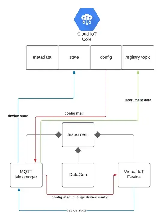

I am writing an IoT device simulator. The simulator is composed of multiple classes. The three important ones are the
  1. Instrument class
  2. MQTTMessenger class
  3. VirtualIoTDevice class
An instrument object constructs MQTTMessenger and VirtualDevice objects and keeps references to them as properties.
The MQTTMessenger subscribes to the topic associated with the IoT devices configuration on GCP IoT Core. A message is sent from IoT Core to the MQTTMessenger when the state changes.
Currently, when this message is received, the MQTTMessenger calls a on_message method, which uses a reference to the VirtualDevice's update_props method, and updates the properties of the device.
Similarly, when the device state properties are changed it sends a message to IoTCore by using a reference to the MQTTMessenger object's update_state method.
Another solution to this architecture would be to have both objects contain a reference to their containing Instrument and then call the methods directly, but I feel that this is a cleaner, less coupled solution. I have attached a diagram to illustrate the current structure.
Is this a good solution or are their pitfalls that I am not aware of? Is there a name for this design pattern?
Class Diagram

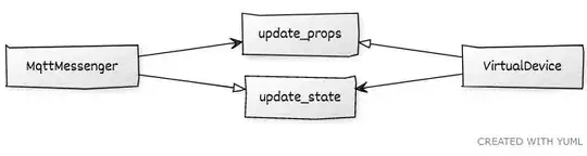

This is the same as having an interface that one class accepts (or maintains a reference to), and the other implements, it's just that you are constrained to a single method per interface. What corresponds to the interface here is the signature of the method. So this is, broadly speaking, just a way to do dependency inversion: two concretions - your VirtualDevice and MqttMessenger classes, rely on an abstraction - the (signature + meaning) of the method each of them references.
So, you have this
and this
The arrow with the white triangle indicates "implements", the other one is "references" (either as an internal field, or as a method parameter). When put together, you get:
