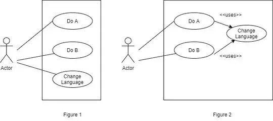

My software provides two functional requirements, and I represent them as Do A and Do B in the figure 1 below. At the same time, my software has a non-functional requirement to provide the interface in multiple languages. To the best of my knowledge, non-functional requirements should not be modeled as use cases, however, I am not sure how to represent this, as at the same time, it seems natural to include the capability to change language as something user would do. Please help me understand.

    Change language is a behavior of the system, so it’s a functional requirement. – Rik D Oct 30 '21 at 08:29
Although usability, accessibility, internationalization and localization, and documentation requirements tend toward non-functional requirements, there may be functional requirements that support these goals. If the system supports changing its language, through user action, automatic detection, or some other means, that is a functional requirement. It defines a specific behavior that the system performs with respect to the language that appears on user interface elements.
Since the system changing its language is a functional requirement and is about the behavior of the system, it is something that could conceivably appear on a use case diagram. It's important to understand what a use case is, though. A use case is a description of a behavior of the system under specified conditions that allows an actor to accomplish a goal.
Not all functional requirements are captured as a use case. The notion of "log in" is a good example. An actor's goal is usually not to authenticate with the system. Likewise, I find it unlikely that an actor will use your system to change the language of the user interface. Because of this, I don't think that the use case of "choose language" should be on the use case diagram, or even modeled as a textual user interface.
If you are using use cases to capture the behaviors of the system, I would consider including it as a precondition. The precondition to carrying out the steps could be something like "the user sets the user interface language to their language" or "the system displays user interface elements in the user's language". Since textual descriptions also contain references to the actors involved, information about the actors or personas can be used to determine what languages the system needs to support and to design test cases that different actors are able to see the system in the correct language.

  • Thanks. I agree that I need to focus on textual description. At this stage, I am trying to understand UC diagrams. Hence NFR do not appear on UCD. FR that implements NFR, does not typically appear on UCD, as it is not main goal of actor. Q1: is it possible to use "USES" to show FR that implements NFR on UCD (plz see updated figure 2 above). Q2: Are there any cases where FR that implement NFR need to appear on UC diagrams? – User 19826 Oct 31 '21 at 03:42
    @Fabiana More recent revisions of the UML specification have replaces `<>` with `<>`, but I do believe they mean the same thing. Aside from not using the latest terminology, the second diagram appears to be correct per the specification. However, choosing to show this level of detail or not is at the discretion of the author of the diagram. Personally, it seems too detailed for my liking, and having this level of detail could add to clutter on the diagram as you add more use cases. – Thomas Owens Oct 31 '21 at 09:53
UML use case diagrams have a very restricted semantics "by design". Hence, to make these diagrams useful, one has to provide a description for each use case (for example, in text form). How you structure this description is up to you, if required, it can also include parts which apply to all use cases of your system. There would be the natural place for a non-functional requirement like "ability to change the language".
