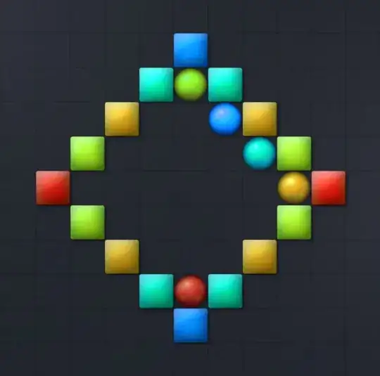

I managed to produce some pictures of some example levels for the game. They are the following, in order of hardness (well, more or less):
This level is fairly simple. Balls can be potted inside the squares with matching color, just like the 3rd party example game above. This level is fairly simple.

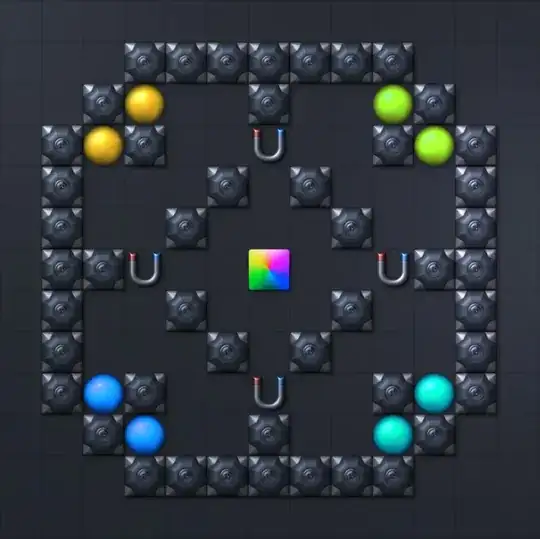

This level is not very hard, but the mine in the center makes it tricky. Mines are objects you should not move over them, or else you lose the game. This level is not very hard, but the mine in the center makes it tricky.

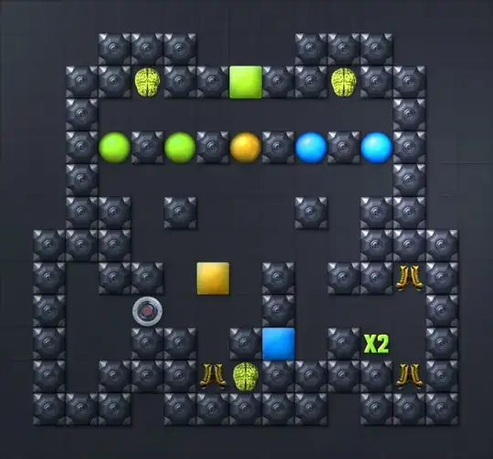

This level is tricky, because balls are stuck within the geometry of the level, and avoiding potting balls is key. To solve this level, a lot of collaboration between all balls is necessary. This level is tricky, because balls are stuck within the geometry of the level.

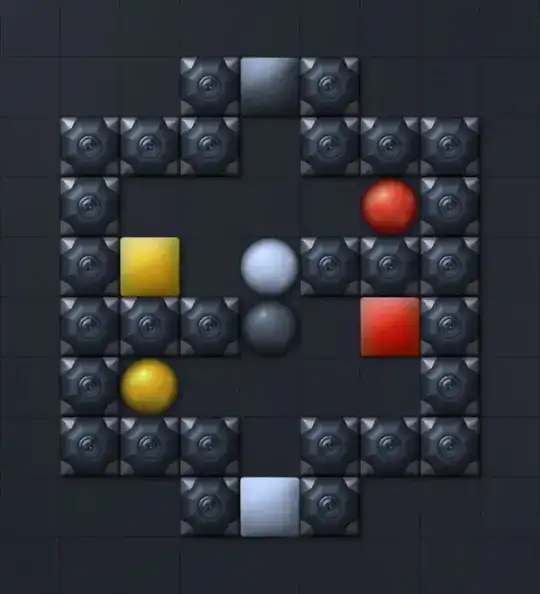

This level is limited to a maximum of 60 moves. That is what makes it a bit harder. The magnets make balls stop when moved through, but they are consumed (i.e. one time use). The square in the center is an Iris slot — any ball can be potted inside it. The key for solving this level within the maximum number of moves is to choose ball routes wisely. A level that is only hard due to the moves limit.

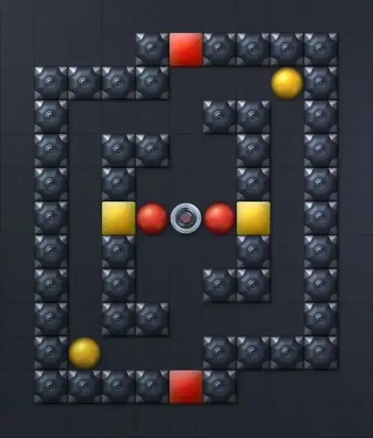

This is the hardest level in these examples. The boots (a pickable item), once consumed, add 10 extra moves to the moves limit. The three boot items, add 30 extra moves in total. To solve the level you need to consume them, or else you run out of moves. But going for the boots will also spend some moves as well, so it requires a careful strategy. The little brains and the X2 are just optional pickable items that give some score. This is the hardest level of these examples.
