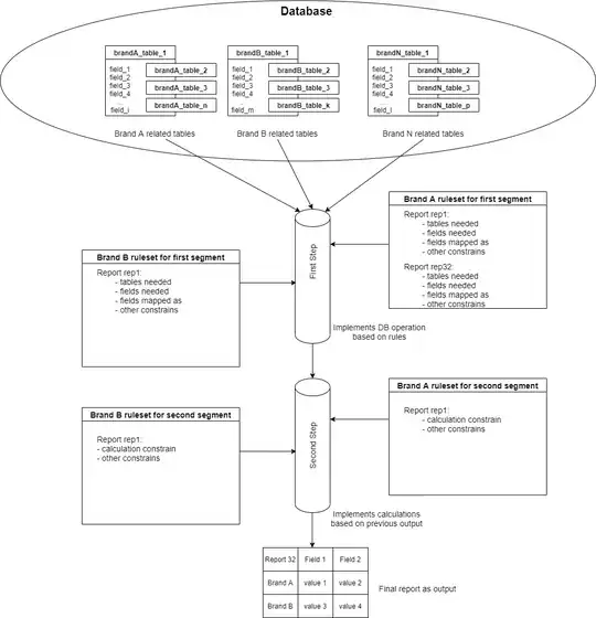

I am thinking on a 'pipeline' style architecture (see attached image), where I just define some rules for each segment and the same algorithm can calculate the result no matter of input parameters. This way if I have to display a new report for Rolls Royce I just define some rules and I get the results. About the rules, I was thinking about table definitions per brands, field mappings, etc.
My problems with this solution is that I have to implement some kind of an interpreter for each step, to analyse and execute the rule sets which is risky, not maintainable, and I'm not sure if it is scalable at all. Are there any other approaches or best practices to avoid repetitive work?

Based on the presented information, a simple interface will cover your reusability needs.
This is not a "rule". This is a different implementation. Your underlying idea is correct but I suggest refraining from calling it a rule, because people will misunderstand your intention.
Essentially, all you have to do is add a Rolls-Royce-specific repository which implements the same interface (cfr step 3 mentioned above).
Note: Because you talked about database tables, this example used different concrete repositories using the same interface. In other cases, it might make more sense to implement this interface on the BLL rather than the DAL. But it's the same principle at play regardless of what layer you implement it on.
