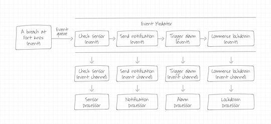

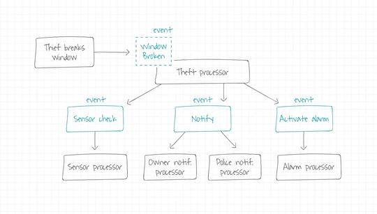

I'm a little confused by your description of the code base. You say its a microservice architecture with duplicated code across the services. That is by definition not a service. It also violates the definition of a facade as a facade should not have any hard coded requesting within it. The implementation of the interfaces function calls should be decoupled from the interface itself. The only time you should have to make a change across microservices is if you change the function call or API call reference name (for components vs services respectively). If done as intended, the new implementation updates should be followed by all microservices when you update the implementation.
Services are (should be) essentially containerized apps with their dependencies locally hosted so that if another service changes, then no redeployment is necessary for sister services. This is used for distributed architectures where the services may not be on the same machine and shared libraries are impossible.
Components use shared libraries so that duplication is minimized across an application for storage reasons. Mostly useful in monolithic applications. But if one component requires a certain version of a library and another component uses another version of the same library then you get the matrix from hell situation.
I believe your quickest solution is to add an event queue and event log and message broker to so that no calls are made FROM the services but all events are sent TO the services. And keep in mind that an event can be anything, so you just keep your http logic just send it to the queue instead of to another microservice. You could even preempt the broker with an event processor that could have encoding logic so that you could backward compatibalize any API changes.
This gives you the benefit of adding and deleting any services in a central location easily and future proofs (HA!) your API
See these diagrams: (Not Mine) Mediator Topology Broker Topology
