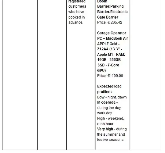

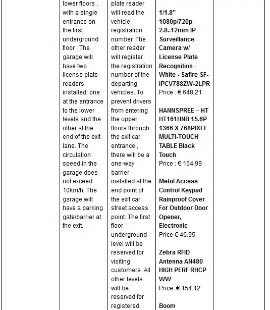

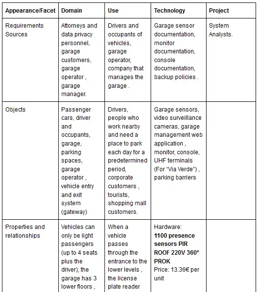

First we were given a document with the problem and had to extract requirements from it into a Word document. The project was about the software for a parking lot. That part didn't seem so weird to me, but then we had to fill in a bunch of other things in this Word document which would later be called "report" (at this point it was just called "Component 1"), such as a context that is a grid with this format:
This Word doc also had a "change history" which we never ended up using. This report also described the software, the client, the quality and functional requirements, the restrictions, and the drawings.

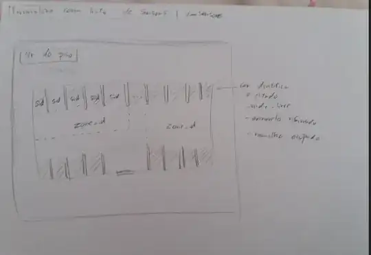

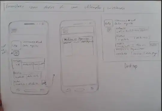

These drawings are pencil sketches of some functionalities of the software, ie creating an account, with all the steps. Here are my drawings (the first one is a user profile and the 2nd one is a blueprint of the garage with the sensors and zones):

Penciled sketches are still done, but there are also wireframe software and other types of mockup software that you can also use.
