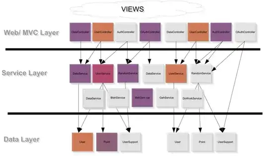

I've seen a couple of talks on Hexagonal architecture where they illustrate problems with N-tier architecture. Specifically, they show a spaghetti of service layer dependencies as the software grows. For example, the image below is from the Hexagonal Architecture with Grails talk: https://www.infoq.com/presentations/hexagonal-arch-grails/
hexagonal architecture with grails
I agree this is typically where N-tier apps wind up as they grow. But I don't really understand how hexagonal arch avoids or improves this situation. The business logic will still have the same dependencies. Those dependencies exist because some business code (whether intermingled with framework/persistence code or not), needs to call some other business code. Whether it's in a service layer or in something we call "core" seems irrelevant.
Somewhat related is the concept of number of layers. While the talks on hexagonal architecture say it's a single layer architecture (or outside versus inside), it all comes down to perception or how it's drawn in diagrams. In my view it's still N-tier, except we can call the web tier and data layer "adapters". Whether it's represented as horizontal layers or vertical slices seems more a matter of illustration or code organization. But the latter is often dictated by our framework.

I would not say the diagram is representative of what layered architectures look like. The diagram doesn't show the dependencies within a layer. Also, OAuthController skips a layer, so that means that you have some domain login in the controller (I think that is called loosely layered or something along those lines).
