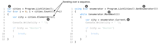

Example of a decorated piece of code in a context of an explanation of why for and foreach are completely different constructs in C#. The digits in circles have the same role as line numbers: to be able to pinpoint a specific place in code.
