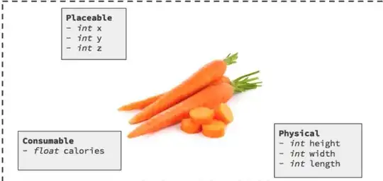

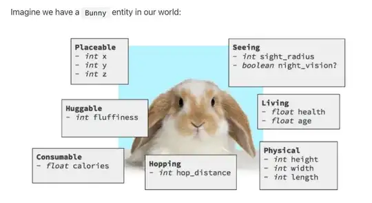

I'm familiar with the typical RDBMS backed MVC web app framework. To illustrate what I am thinking of, let's use the examples of Bunny and Carrot from this [article].

First, we would have each component become separate tables.
so we would have the following tables:
  • placeables with the fields x, y, z
  • huggables with the fields fluffiness
  • seeings with the fields sight_radius, night_vision
  • livings with the fields health, age
  • physicals with the fields height, width, length
  • consumables with the fields calories
  • hoppings with the fields hop_distance
And in all these tables they will have an entity_id as foreign key.

So Bunny is an Entity Type which means it's represented as a row inside entity_types Same as Carrot.
A specific Bunny will be an actual entity with the id 1 and entity_type_id as foreign key in the entities table.
What we typically do of establishing the fields of a Bunny in a MVC way would be to put the fields inside the bunnies table.
Here we simply have a relation table entity_type_to_component_types where the Entity Type Bunny is related to the specific Component Types
