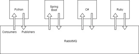

We have a bunch of microservices written in different programming languages. These all communicate with each other over RabbitMQ(AMQP) middleware. There are consumers and publishers in each microservice which listen to incomming messages and publish on a RabbitMQ exchange respectively. The current architecture is shown in the image below

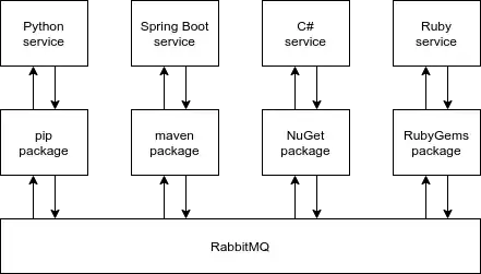

I want to decouple the Rabbit specific consumers and publishers from the microservices and implement them in a separate shared library as follows.
This shared library shall implement RabbitMQ exchange bindings. The consumer in this shared library, should listen to any incomming messages and invoke the relevant method in the target language. Same for publishers, the target language should be able to invoke a method in the shared library responsible to publish message on RabbitMQ.
The problem I am facing is in making target language bindings with my shared library.
How should I share the functions of the target language that can be invoked by the shared library?
The reason for having a shared library is because, I can swap the current RabbitMQ message service with any other.
I request for some suggestions to approach this problem

    Since RabbitMQ already has bindings for each language - your shared library approach is not necessary. Simply define the API you want to restrict your microservices to (or what features you want to add) and then implement it for each language you need. Since your API will expose features common to all messaging systems only (since you want independence from a particular messaging system) it will in each language be simply a thin wrapper over RabbitMQ's binding. Easy to write, easy to test. In each language. – davidbak Mar 26 '21 at 15:11

  • @davidbak: Writing wrappers for each language would ultimately create dependency on each microservice. A shared library would decouple excatly that from my microservices implementations. Also I would be able to write test cases independent of any messaging service. – Nishant123 Mar 29 '21 at 06:40
  • Perhaps I didn't understand your question. Sounds to me - and the drawing looks like to me - that you want a wrapper _not_ around your microservices but around your _messaging system_. "So that you can swap the current RabbitMQ message service with any other." – davidbak Mar 29 '21 at 16:04

Most languages/ecosystems have packages, and a system which manages those packages and the dependencies between them: pip for Python, npm for JavaScript, NuGet for C#, RubyGems for Ruby, etc.
You create your wrapper as a package, and you rely on it from every service which uses a given language.

  • Thank you very much for your answer. Actually all the services that I have mentioned are developed by teams spanning across different companies. The shared library approach that I have mentioned is an attempt to tie those services together without major changes to the existing services. The wrapper approach you mentioned, is promising, but wouldn't that extra code layer on top of the each service, be an invitation to(and handling of) new potential bugs? – Nishant123 Mar 31 '21 at 08:47
    `wouldn't that extra code layer on top of each service, be an invitation to(and handling of) new potential bugs?` Look at it this way, the shared lib could be buggy too and then everybody is affected by the same bug and blocked by the same roadmap to the solution. While Arseni's suggestion might affect only some of the consumers, not all of them. It's also important to bear in mind that different teams, different needs. Your unique shared lib would be hit by many and different needs, pulling in different directions. Generic, unique silver-bullet solutions rarely end well. – Laiv Mar 31 '21 at 10:18
