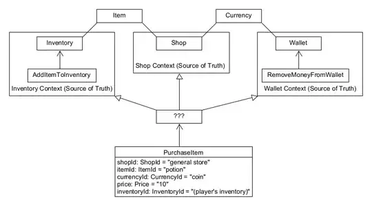

diagram showing interaction between purchase item command and inventory, shop, and wallet contexts
This diagram kind of illustrates what I'm working with. I have 5 different models, Inventory, Item, Shop, Currency, and Wallet. This is a collaborative, disconnected environment. What I mean by that is, each of these models is designed to not necessarily know about each other, except when necessary. I want these models to be reusable, by unknown third-parties, resulting in other compositions, aside from the ones that I can think of, or the one I'll talk about here.
For instance, the Item model doesn't know about the Currency model, or the Wallet model, or the Shop model, or the Inventory model. But, the Inventory deals with storing Items, so it knows about Items. The Shop model knows about assigning prices to Items, so it knows about Items and Currencies. The Wallet model knows about storing and keeping track of money, so it knows about Currencies.
Items can be added to a specific Inventory by using an AddItemToInventory command. Money can be removed from a specific Wallet by using a RemoveMoneyFromWallet command.
When a Player wants to buy an Item from a Shop, they select the given Item, and if they have enough of the specified type of money in their Wallet, they confirm they want to buy it. At that point, the money is removed from their Wallet, and the specified Item is added to their Inventory.

I've been trying to figure out how I can avoid these particular issues. My initial thinking was that this would be managed in a single transaction. The problem though is that these are in different models, different contexts, different Aggregates. Because they are different Aggregates, they shouldn't be updated in the same transaction. Other Aggregates could be updated asynchronously, in my case via published Domain Events. But because they're updated asynchronously, that still leaves open the problems, where items are given, but money isn't taken, or money is taken, and items aren't given.
In the diagram, I have the PurchaseItem command going into a ??? component. I don't know what it's supposed to be. I didn't want it to be given to the Shop Aggregate, because then the Shop context would have to know about Inventories and Wallets. It knows about Items and Currencies, but it feels improper for it to also know about Inventories and Wallets. The Shop should work in exactly the same way, whether the Item is added to an Inventory, and funds removed from a Wallet; or if the Item is added to a Package, and funds removed in one batch at the end of the day from a Customer Account, or any other combination of things.
So more than one Aggregate can't be updated at a time. I'm thinking that either another Aggregate needs to exist somewhere else, which becomes responsible for this interaction. This though would move the Source of Truth to this new Aggregate, making these targeted contexts, sometimes the Source of Truth, sometimes not. More like Eventual Source of Truth.
Or, maybe it's acceptable to create a new Aggregate, in a different context, which uses the same Entities and Value Objects of these other contexts. But these other contexts would still own their own data, so it would still be Eventually Consistent. I read in Implementing Domain-Driven Design about a bargain basement Domain Model, where three separate models were used, and a question was posed about whether it makes sense to introduce a new model for the interaction. My problem with that approach is that I still need these other contexts to exist as they are, because third-party developers will use them for completely different purposes. Using Items for Equipment, Money for Quest Rewards, In-game and out-of-game Shops. So I can't just condense these all into a single model, without also forcing those developers to NOT use most of the model that's available.

    The internet is very confused about DDD and I think if you *weren't* trying to follow "DDD design principles" and various "rules" you can find there, you'd end up with code that's *more* aligned with DDD philosophy. For example, you said "because they are different Aggregates, they shouldn't be updated in the same transaction", but that's kind of backwards - instead, you'd spot some business behavior that would be problematic if updated in the same transaction, and then you'd change the design so that you organize your domain objects into separate aggregates to support *that*. 1/2 – Filip Milovanović Feb 24 '21 at 17:16
    Also, what you call bounded context aren't bounded contexts as defined in DDD. This is all a single bounded context; and your "contexts" are just logical partitions within that. So don't worry about any aspects of DDD that have to do with different bounded context, because you don't (and most likely *shouldn't* have) anything remotely like that here. I feel like you're trying to shoehorn the needs of your game into your initial idea of what the design should be (so that it adheres to the "rules of DDD"), rather then come up with a design that serves those needs. 2/2 – Filip Milovanović Feb 24 '21 at 17:16

The final bit of good news is that you do not need to go the above route (and if/when you do reach that point, it will be a good problem to have). How much easier would it be if you just locked and updated your data in a single transaction? I urge you to make a list of the pros and cons. You will find that the only real issue with a single transaction is that it limits availability. Are you having problems with availability?
DDD has nothing to say about database transactions. The boundaries around aggregates are logical boundaries. This is often a point of confusion. DDD doesn't mandate eventual consistency.

Create a new entity called "Transaction" or "Purchase." Each instance of this entity records the event when a user requested and completed a purchase (Note that "requested" and "completed" are not the same thing).
The workflow goes like this:
  1. User requests a purchase
  2. System create a purchase record with an identifier specifying which item was requested for purchase
  3. The purchase record contains blank slots to store
    (a) The identifier that is created as a side effect of collecting payment (e.g. a confirmation code or transaction ID). This is left blank until payment is actually collected.
    (b) An identifier that specifies which item was moved to the user's inventory. This is left blank until the item is actually moved.
  4. After all identifiers are populated, the purchase record is marked as "completed."
At any given moment, if your system is not certain of the integrity of a transaction, it can go back and look at the record. If the payment identifier is blank, it knows to go back and collect payment. And if the item identifier is blank, it knows to go back and move the item to the user's inventory.
This new entity must know about items and payments (obviously), but items and payments don't need to know about the new entity, preserving your loosely-coupled design.
