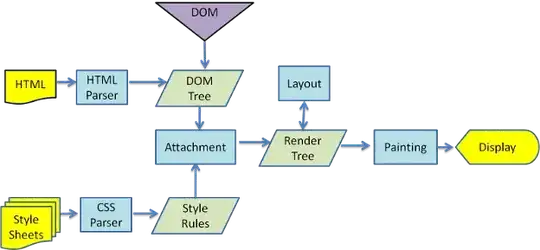

The rendering engine of a web browser which is in charge of displaying a page based on the DOM and the CSS rules applied to it.
medium.com - how web browsers work
