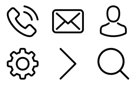

I have several drawings from SVG files which basically contain basic outlines of figures. They are constructed in segments of various shapes (lines, ellipse arcs, Bezier curves ect.) Something like this (maybe not the best example):
I want to create an algorithm that traces (draws over) the countour of all shapes once. This means that it has to jump from one figure to an other (or to the same figure) at various points. Also it should prefer go from right to left. I guess it could be represented by a weighted undirected graph where the edges represent the shapes, but each node is also connected to all other nodes via jump. The jump could then have high weights as well as the nodes to the right. I would then have to create a trail, except that the jumps would have to be visited. I don't know... I not good at graph theory.
I know this is vague, but maybe someone knows of a path (or trail)-finding algorithm where expensive jumps are allowed or something like that. Maybe some network or complexity stuff?
