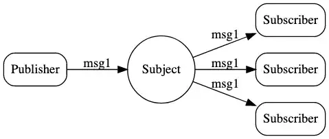

I see this word in many places but don't get it.
From the Wikipedia,
In message-oriented middleware solutions, fan-out is a messaging pattern used to model an information exchange that implies the delivery (or spreading) of a message to one or multiple destinations possibly in parallel, and not halting the process that executes the messaging to wait for any response to that message.
but I don't know what it means under other contexts, for example,
Can you please explain this term to me? Are there other places using this term? Thank you.

  • In RabbitMQ at least, the term 'fan out' refers to a lack of routing or filtering intelligence; any subscriber(queue) attached to a fan-out exchange will always ignore all routing keys and filter patterns, and therefore messages published to that exchange are always delivered to all subscribers. On the flipside, RabbitMQ supports routing models where subscribers can choose to filter the messages they receive based upon some pattern matching and routing key rules. So in that context at least, fanout just means unconditional delivery to all subscribers. – Ben Cottrell Jan 13 '21 at 23:22
Indeed that Wikipedia definition misses the point.
Think in terms of a data flow diagram. Each processing node can have its output wired to 0 or more downstream nodes. In a visual diagram, those output wires look like a hand-held paper fan. Those wires or number of wires is its fan-out.
A node's input can be wired to multiple sources. That's its fan-in.
