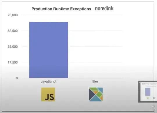

How does a functional programming language, such as Elm, achieve "No runtime exceptions"?
Coming from an OOP background, runtime exceptions have been part of whatever framework that is based on OOP, both browser-based frameworks based on JavaScript and also Java (e.g., Google Web Toolkit, TeaVM, etc. - correct me if I'm wrong though), so learning that functional programming paradigm eliminates this is big.
Here's a screen grab from NoRedInk's presentation on Elm, showing the runtime exceptions from their previous JavaScript-based code to the new Elm codebase:
Enter image description here
  • How does the functional paradigm or programming approach eliminate runtime exceptions?
  • Are runtime exceptions a great disadvantage of OOP over functional programming?
  • If it is such a disadvantage, why have the OOP paradigm, programming approach, and frameworks been the industry standard? What is the technical reason? And what's the history behind this?

That's easy. You simply don't write functions that fail.
That might sound simplistic, but that's the gist of it.
Take division, for example. We can simply define that anything divided by 0 is 42. Boom. Now, division no longer throws a runtime exception, it just sometimes returns a wrong result.

The key point is simply to write your functions in such a way that they never throw an exception and always return a value.
Note that this has nothing to do with Functional Programming. You can do this in any language. For example, C also has no runtime exceptions. In C, you use "magic" return values or error codes to signal errors.
You could do this in Java as well. In fact, Java ships with an implementation of that Maybe type called java.util.Optional and you can write a similar Result type as well.

It doesn't. Writing code such that it never throws exceptions eliminates exceptions.
  • Are runtime exceptions a great disadvantage of OOP over Functional Programming?
They have nothing to do with OOP or FP.
  • If it is such a disadvantage, why is OOP paradigm, programming approach and frameworks have been the industry standard?

Hence, the statistic you showed is just junk - yes, there may not be any exceptions in that particular language, but just because it doesn't implement them.

Apparently the author supposes that there are no runtime exceptions in functional programming languages such as Elm (hm... what does it really mean to be such as Elm, I wonder...) and that the picture the author shows says that there are no runtime exception in Elm. Both presuppositions are actually wrong.
  1. Programms written in functional programming languages can have runtime problems. The actual saying is something like "once it compiles, it usually works".
  2. There are runtime problems with Elm on that picture, we simply don't see them, because they are provided in a quite a small quantity (the speaker in the source talk says that).
