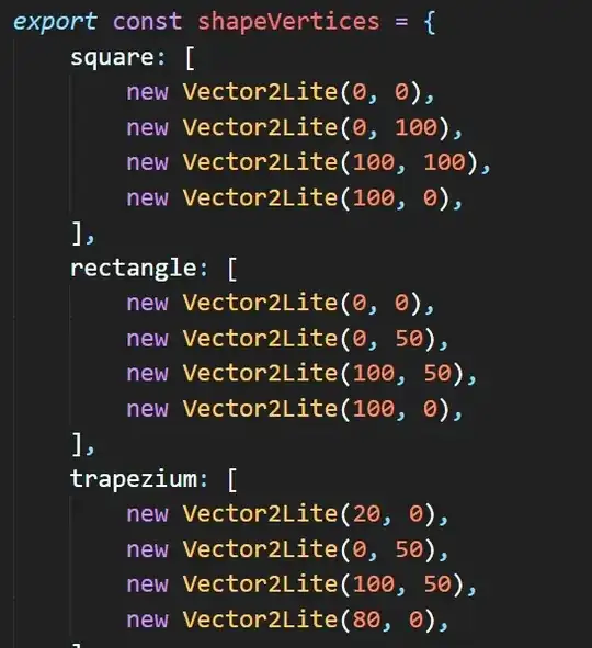

I hope these examples are enough to demonstrate why I am stuck so much. I can't find common multiple of all this stuff that I could abstract out(Well except that all these shapes are made of vertices, oh wait, Circle & Oval don't have any vertices. DAMN!).
I have one straightforward idea of doing this, by putting tons of "dumb" work, I will be able to finish this app in a month, but It won't be scalable or maintainable in any way. Its a dumb way of doing it (Basically will be equivalent of writing separate application for each shape).
The app is for Android written on React Native, so I am using SVGs(for performance, obviously to make this even harder).
I already have "Engine" that is able to draw & animate SVGs from supplied vertices.
Currently just parsing vertices anti-clockwise and building a shape.
