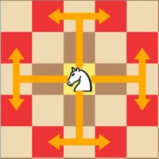

A piece can only know how it is supposed to move if it knows its current location,
That's not true at all. I think you're getting confused here by tying relative movement and board coordinates together as an inseparable whole. They both factor into calculating a valid move set, but they are separate steps that can be undertaken by separate actors.
A piece is perfectly capable of knowing how it can move relative to its current position. Simple example:
This diagram explain the transformations (moves) that a chess piece can make, but it does not rely on any board coordinates. It explains the movement relative to the starting position.
You could develop a system where the pieces only communicate using relative coordinates. I.e. the piece tells the board "I can move two cells to the left and one down", rather than "I can move to C4". This wouldn't require any input at all, this knowledge is perfectly encapsulated by the piece's internal logic.
The board, after having received these relative coordinates, could then translate them into actual board coordinates. The board knows that the piece is currently on E5, so it can calculate that "two cells to the left and one down" means C4.
However, at least for boardgames with a restrictive set of tiles like chess, it's usually easier and clearer if you always use your board coordinates, and don't implement this relative coordinate system.
If you wanted to be able to express those target cells using coordinates, I would need to supply you with the coordinates from the starting position. If I told you that the knight was on E5, you could figure out that the target cells are C4, C6, D3, D7, F3, F7, G4, G6.
This means that we already have a good idea on how to implement this logic:

I refer back to the diagram:
You're right that if there were e.g. a white pawn located on one of the listed target cells, that this move would not be valid.
But I also refer back to my initial paragraph: an object only knows itself. Therefore, if a piece tells you its valid moves, it doesn't yet account for other pieces on the board. That is a secondary calculation you have to do on top of it.
