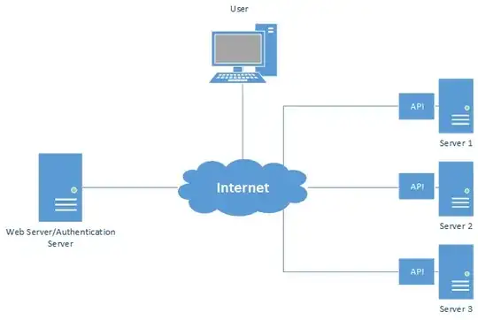

We have a Web server (which also does authentication and authorization) that manages, via an API, one or more servers that contain highly sensitive data. In the below architecture diagram, we manage everything except the end user: Architecture Diagram

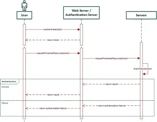

The following diagram outlines the use case for a user wanting to access a protected resource on a given server: Use case
The reason the token is passed through the Web server is so that we can restrict connections from anything other than the Web server (via IP Address).
Ideally none of the servers, except the Web Server, need to know about all the users.
However, the greatest concern with this is that the Web Server is our single point of security. From my knowledge, if an attacker got full access to the Web Server, they'd be able to issue themselves a valid token and access the protected resources of the other servers.

Yes, if the attacker gains control over the auth server then they can generate their own tokens.
However there isn't much you can do about that. The auth server needs a private key in order to be able to sign the tokens.
What I would do is separate the auth server from the web server. Hide it behind a firewall and have the webserver call it. This will reduce the attack surface of the auth server
