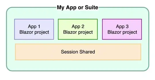

We really want to create something similar to Google's App Suite (One login, multiple apps, same UI). While researching how to have one UI, and hopefully only one authentication call, I came across this article (https://gorillalogic.com/blog/four-micro-frontend-architecture-types-you-can-implement-with-blazor).
The Method 1 section from the above article (Use micro-apps with a shared session and parameters) seems like the way to go. The article states, "To do this with Blazor, every app is a Blazor project and they have shared session information between them (see illustration below)."
Micro-Frontend
I am not entirely sure how you would even design something like this in Blazor. How can you create a shared session between Blazor Apps when each runs on it's own Kestrel server? Is there some type of way to creating an outer "container" app that houses the other apps?
