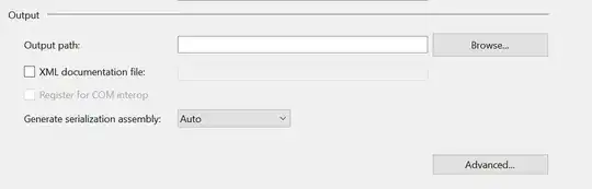

If you look in the the build section of the project properties you could see an output section, this has an option to export the comments as xml. This is useful if you want to generate more resources form the comments.
In Visual Studio:
build output
There are third party solutions to generate various outputs with this xml, however you can also work with it quite easily and it can be integrated in tool chains.
