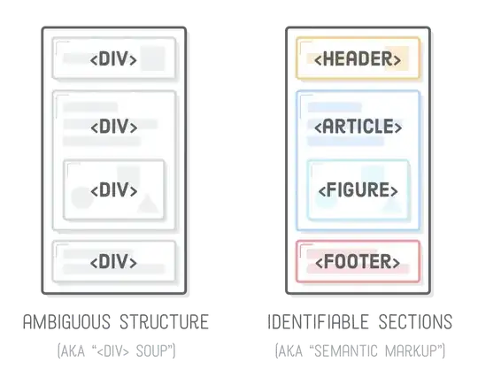

See below image (from the article) for the old way and the semantic web way to code.
