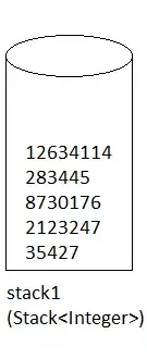

My question also apply to other data types, for example do I think of a Stack of integers as the container of the stack of integers, for example:
Or do I think about it as the stack of integers only, for example:
I think the term "stack of books" in real life only means the stacked books (without having a container that contains the stacked books).

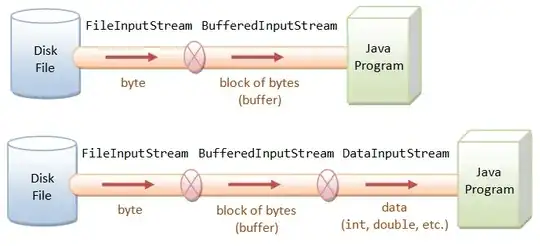

But if we take a look at the Java documentation we see they used a pipe metaphor. The OutputStream abstract class has an open() method, a close() method() and a flush() method. All of that indicate the piped water metaphor.
You should not forget that streams usually have a buffer, at the input end, at the output end or at both ends, so you could actually draw like a small tank where a buffer should be, meaning that most streams are not written or read from until some buffer is full. If you want go go full with such a metaphor, you could put a spigot meaning close() and open() .
A metaphor is a tool to help understanding, I believe this pipes metaphor is good enough regarding Java InputStream, OutOutStream and their specializations, but you could really go with almost any of the examples the Google Image Search brings up.
But when it's time to user readers, buffers and all the plumbing I believe abstract symbols, arrows etc. will suffice, since the "piped fluids" metaphor begins to leak (pun intended).

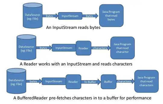

Here the thicker components coincide with those that one could think implement a buffer
Regarding a stack, you can use a vertical rectangle open at the top. thick lines represent items in the stack, but items should always be flushed with the top of the stack and perhaps an upwards pointing arrow in the empty space in the lower side of the rectangle.
