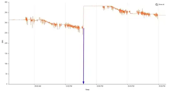

I am working on a project in which I have to read data from liquid level sensor installed in tank which measures fluid level and sends output in millivolt. The device has predefined ranges of voltage to decide fluid level from voltage. The tank might be fitted on moving vehicle as well. I have to represent this data on graph.

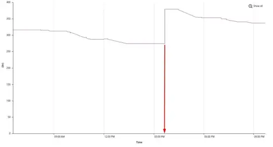

Now, the problem is that the data sent by some devices is very fluctuating as you can see in below screenshot. enter image description here In order to show smooth line, I used linear regression by creating bunch of 30 minute duration data and applied it on each bunch. The result is as below. enter image description here As you can see, linear regression works pretty well and gives me smooth line but, the problem is that the refill event is delayed by hours.
So, my question is what are the possible methods which I can use to by which I can show smooth line and refill events on actual time as well?

    for many purposes, a simple moving average is sufficient. However, if you have appropriate domain knowledge, you can select an appropriate kernel function for this smoothing. Piecewise regression is likely misleading because the graph will depend on the selected intervals, though my guess is that the delayed refill event is due to a coding error in your regression. – amon Aug 06 '20 at 23:17
    I agree with Amon. This looks like a coding error. Anyway, try a low pass filter. So long as the refill signal is this much bigger than the noise it should be fine. – candied_orange Aug 07 '20 at 01:17

For a vehicle tank you need to consider two types of value change: slow fuel consumption and fast fill. There are also at least two types of measurement error sources: quick fluctuations due to movement (noise-like) and medium-length aberrations due to the vehicle being parked at an angle. You see both of these effects in your data. Temperature may also have an effect but to compensate for it would require measuring and calculating the contribution, which is probably overkill.

Exponential smoothing (Hans-Martin above) is a good way to go.
SmoothedValue = ((1 - α) * currentReading) + (α * PreviousSmoothedValue)
where α is the smoothing coefficient. Any spike (change in regular pattern, maybe caused by liquid movement at the time of measurement) will impact the series, but its values will be smoothed out over the next few ( depending on α ) values. To derive a suitable coefficient, you need to determine the sampling rate of your tank sensor. From your graph it appears to be more frequent than once every 10 seconds, maybe once every 2 seconds. Next choose a length of time for the smoothing. You suggest that the 30 minutes you used is unacceptably long, maybe 30 seconds would be acceptable as long as there is AT LEAST 5 measurements in the interval. After this time length any spike will be completely smoothed out. Then set (1 - α) to be the reciprocal of the number of measurements in this time interval.
The tank re-fill at 12:30 PM appears to happen quite fast within one measurement interval. If you are prepared to accept a narrow "S" shaped curve for this fill (instead of a vertical step) then you won't need the threshold test.
